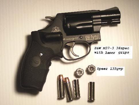

thanks, Doc, for your excellent advice and sharing your experience. I like the laser grips on my (not mine anymore, see note below) S&W Model 37-3, which also handles +p just fine. Here's a look at the mod 37 with the laser...

Oh, BTW, my wife liked the mod 37 with the laser so much it's now her gun. Darn! :(
